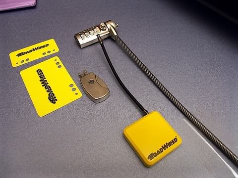

RoadWired® has a very interesting and unique product called the KeyCard TraveLock™ Security Kit. RoadWired® designed this lock with the concept of providing an alternative solution to securing luggage and laptop computers without the hassles of dealing with small keys or having to remember combinations. The TraveLock™ Security Kit consists of one KeyCard lock, two keycards (one large, one small), one laptop lock adapter, one 60” cable and one 4.5” cable; both cables are braided galvanized steel with a PVC coating and brass headers. RoadWired® states the cables can withstand 330lbs, the KeyCard lock holes can withstand 110lbs, while the laptop lock adapter can withstand 70lbs. If the lock functions as advertised that should be more then enough strength to properly secure your laptop.

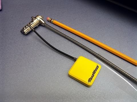

Standing next to the RoadWired® KeyCard™ lock is the widely popular Targus DEFCON™ CL that I purchased at a local OfficeDepot for $29.99 which has a cable thickness of four millimetres (0.16 inches). Unfortunately RoadWired® did not provide the thickness of their cable on their website; I would guesstimate the thickness to be two to three millimetres.

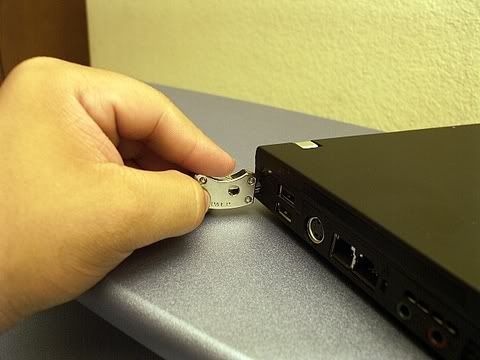

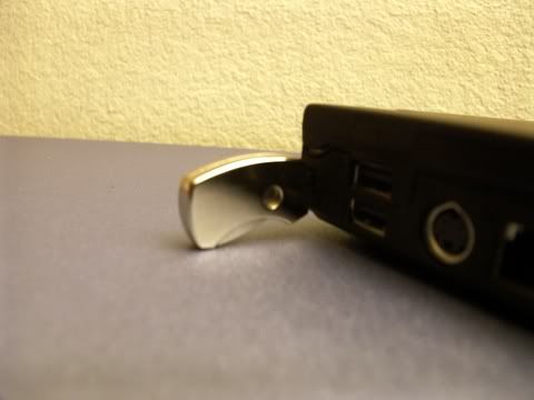

When I first opened the package and started playing around with this lock I found it really easy to lock and unlock. I did not have any trouble switching the cables from short to long and vice versa. I did however run into trouble using the laptop lock adapter. While RoadWired® shows it being used to secure an IBM® Thinkpad™ I could not secure my newly acquired Thinkpad T43. When attached to the security slot on my laptop the hole in the laptop adapter is still closed – it should be open so that I can slip a cable though. Granted it is quite possible IBM has changed their slot and it is impossible to make an adapter to fit all security slots when they aren’t a strict standard. However I feel that this kit should have come with an alternative method of securing a laptop – for example many laptop locks come with a adhesive lock plate and also worth noting is that the Targus DEFCON™ CL attaches without issue.

Using the included keycards it takes me about 2 seconds to unlock this product. Defeating the lock using good old fashion gravity is even quicker. The easiest way to defeat the lock is to drop the unit from a height of four feet or higher onto a hard surface. That’s right, as odd as that sounds, simply dropping the unit or banging the corner nearest to the keycard slot will defeat the locking mechanism and cause the cable to eject open. When I inspected the unit, the pin inside the left hole (when logo is facing up) appeared to be quite small and every time the cable disengages from impact, it’s always that slot that gets released.
