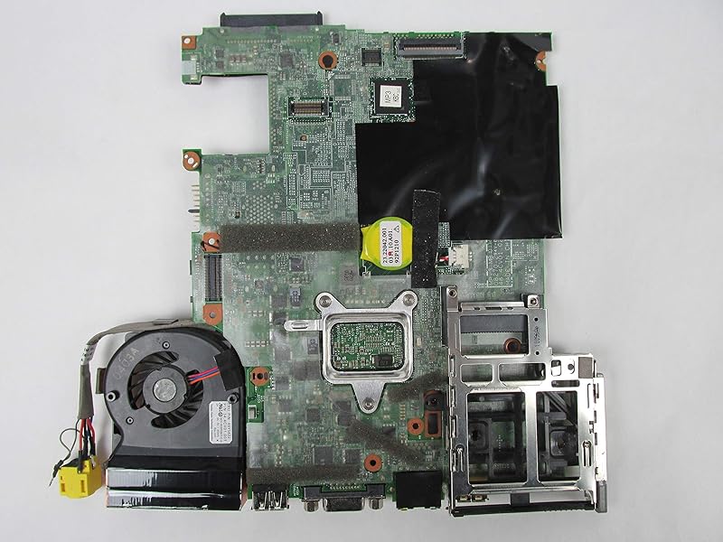

for the rear "thing" I mean this triangular-shaped metal plate that holds the heat sink on the back of the motherboard.
Once the screws are removed, this plate detaches from the MB and putting back in place to screw back after placing the heat sink on the "pasted" processor is not easy.

Re: X201s: "Peel the thin film off" (pag 135 Manual)
You hold that metal bracket in place underneath the motherboard, then put the fan on.
If you really must, you could use some tape to keep the bracket in its place.
