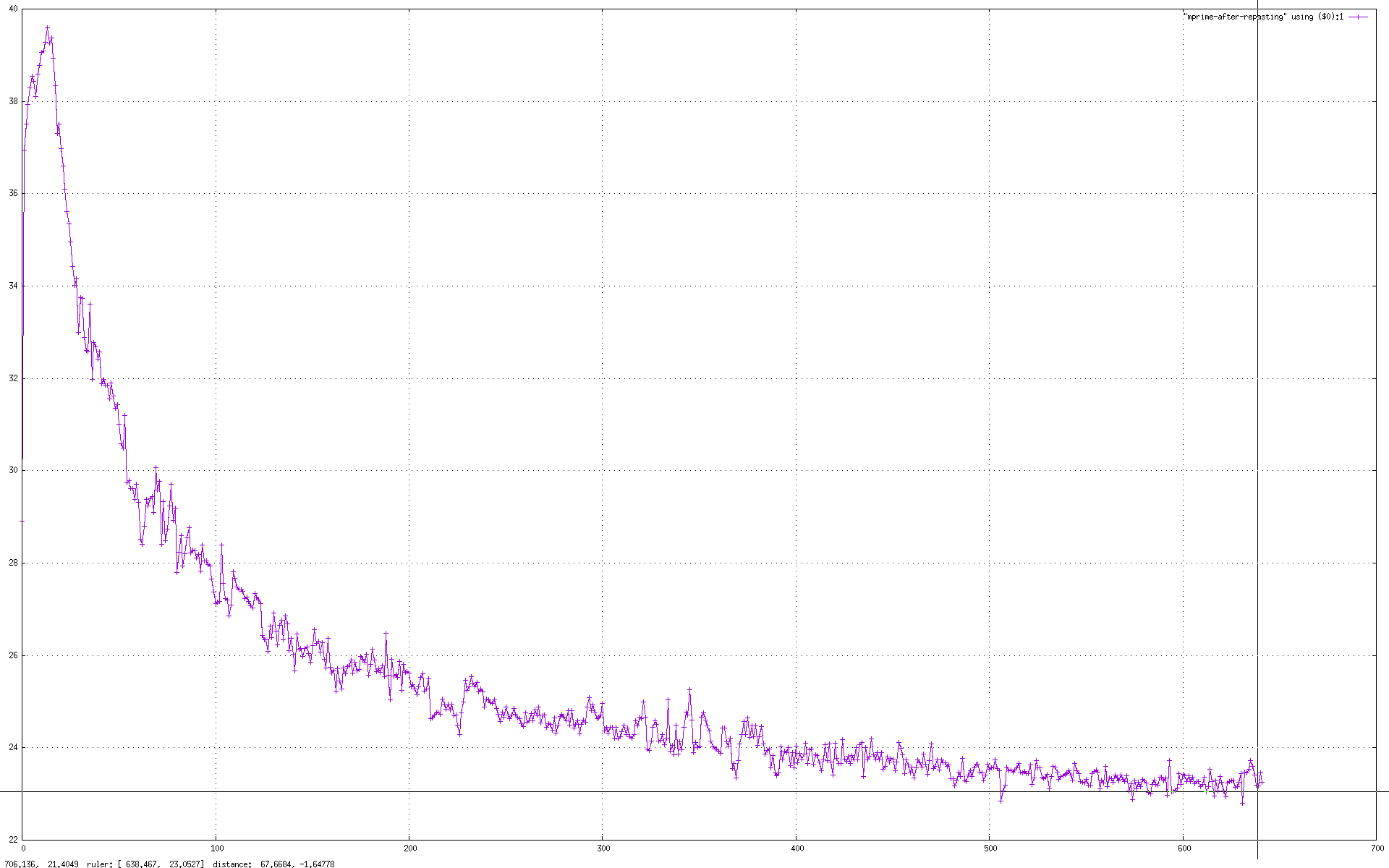

Increased the output power by ~30% by adding a bulky 120mm fan to the RAM bay: http://vperde.l29ah.blasux.ru/dump/7367 ... oling.jpeg
Power plot, running mprime limited at 93°C (reported temperature is about 95°C), before and after: https://tinystash.undef.im/il/5QNQzQmbU ... Z7s6uEFYuG
You can see on that plot that any power benchmarks should be done on this laptop for AT LEAST 10 minutes to let the internal temperatures stabilize. My previous benchmarks and 51nb/xytech ones sadly lack this.

I have a cool update (no pun intended...or, maybe). I replaced the stock thermal paste (some gold stuff) with my trusty (old) Arctic Silver 5 and re-ran the tests. The results are actually pretty good.
First, here's the cooler I have (the 3-pipe one) and the paste which was on there before I replaced it:
Then I ran the same test as before, 10 minutes of sysbench (see above) and monitored with "throttled --monitor". Amazingly, the machine NEVER ONCE thermal throttled and stayed at 3.9Ghz the whole time! Here is the temperature plot. It looks like it got pretty close to throttling though, so if it had run for more time it might have:
And it looks like the dissipation is now up to 36.5W!
sysbench returns 8615 events / second.
R
R

Meanwhile i've repasted my cooler with GD900. Output of https://github.com/l29ah/intel-powermon drawn with gnuplot during 10 minutes of `mprime -t`: https://tinystash.undef.im/il/3x6iqY1Kd ... 7aiuQzR7pX
That's it, 23W at the end with my crappily modified cooler at 26°C ambient temperature and 95°C CPU temperature (received via ACPI, 92°C limit set with throttled).
