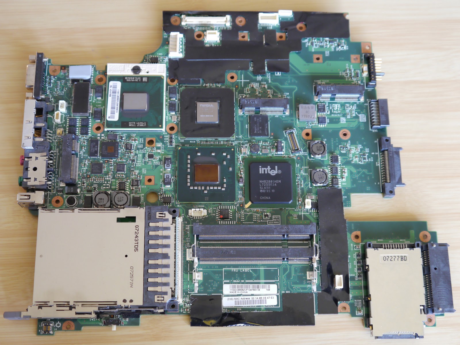

Thx a bunch for info! My 14" 4:3 T61 NVS 140M 128Mb mobo is still in China; only got two crappy photos. I started looking trying to make out how many chips there are. I have found some other photos online. But it's a bit hopeless
There can be more chips under mylar and on the back. Need to wait..
BTW this review of a T61p FX570M/256Mb VRAM has got a high-res photo of the mobo front side. Think I can make out Hynix HY5RS123235B FP-14 on that chip which makes it 700Mhz 536,870,912 bits = 64Mb. Then there's another similar chip sticking from under mylar. Other two are probably either under mylar too or on the back.

Don't know if it helps, but check the pic on my webpage: https://www.theboardroom.info/t61mobo.html

Just so you know 14" and 15" boards may have major differences in terms of these sorts of things due to space restrictions.atagunov wrote: ↑Sun Jun 21, 2020 3:39 pmBTW this review of a T61p FX570M/256Mb VRAM has got a high-res photo of the mobo front side. Think I can make out Hynix HY5RS123235B FP-14 on that chip which makes it 700Mhz 536,870,912 bits = 64Mb. Then there's another similar chip sticking from under mylar. Other two are probably either under mylar too or on the back.
I highly doubt the 14" versions would have 4 VRAM chips because no 14" T6x ever come with 256MB of VRAM.

I know my safe ones are safe because they are replacement motherboards as the manufacturing date is much later than the ship date indicated by the service tag and each of them have one additional year of warranty due to this replacement.
Here I have a gallery of 2 unsafe black glue chips and 3 safe white glue chips from my Dell motherboards:
https://imgur.com/a/eBC1PdV
So in summary, what I have learnt is that the safe chips have a later datecode and a much fatter looking font for the model number, and the later totally redesigned xx1 chips have those on top of using white glue, potentially a die shrink and of course the model number change itself.
Note that this does NOT account for counterfeiting such as etching different model numbers and such, which is apparently a common scam to do in China.
