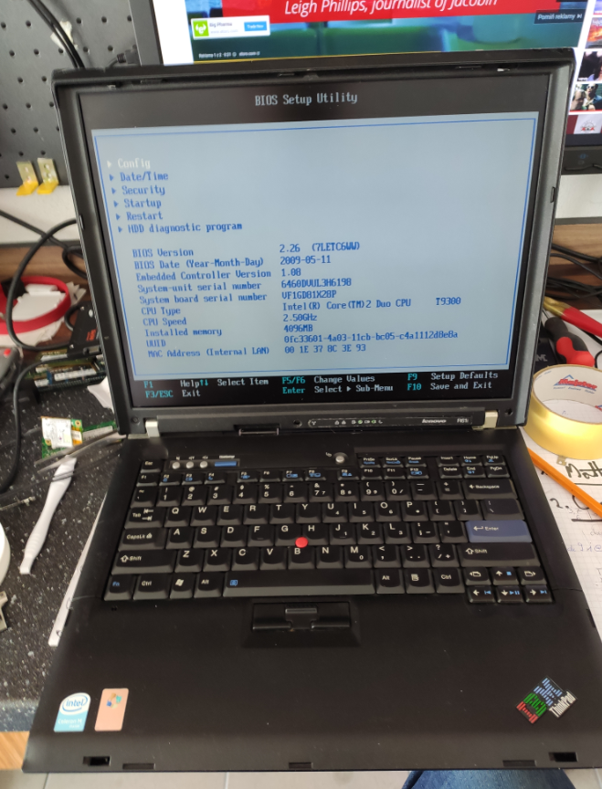

My turn. Project under construction: T61p motherboard inside R61i 4:3 chassis.
1. Why R61? Because R61 is very close construction-and-rigidity wise to A31p that I personally love. Left handside ports fit perfectly. LCD cable is the same, and in the same place. I have an option of Hydis screen installed and a touchpad-free palmrest. Cooling should be better as it is thicker and provides more space.
2. What have been already done? I have already modded the frame to accomodate the board and modded the heatsink to fit properly. Am very happy with the outcome, as the frame did not loose rigidity at all. I need to test the heatsink, as it has lost some lamellas in the process.
3. What are the future plans? Hydis led screen installed. FSB-mod along with QX9300 or - if this comes too hot - P9700 for good clocks and low heat.
4. What are the drawbacks? It loses firewire (oh no!) and ultrabay. However, I will try to fit a UB 3-cell battery in this place. Ultrabay in R61 provides more space, so I might be successfull with that. I am losing exactly one (1) installation point on the mobo. Everything else seem to work so far.
Now what's the hassle? Why do I bother with system that old? T61 is still snappy enough to take care of everyday tasks. Its GPU options are poor, however. So I decided to go an inconvenient way, and get something that will suit me nicely. Fx570m 256Mb is FAR superior to any other option, power-wise, and it will work perfectly for all my 4:3 retro gaming ^^
Pictures will follow. I need to get all the missing stuff first :)

Hello sir, apologies for not being versed enough in R61 family :)
- is this a 14" or 15" 4:3 you're building?
- which T61p motherboard did you pick up?
- that Hydis led - is it a new purchase or something you've had for years? diy-led or "ex-factory"? what resolution?
Good luck with your project!

Your link to the 15.0" T60(T61p) has the 128MB vRAM FX 570M, not the 256MB version. There is a big difference in difficulty, especially if you retain full ultrabay functionality.
wujstefan

#4 Post by wujstefan » Fri May 22, 2020 9:21 am
atagunov wrote:
Fri May 22, 2020 8:10 am
15" 4:3
FRU 42w7877 - Penryn-native T61p 16:10 15,4" w/fx570m
I have one last spare, but I will order a couple more just to have some when in need. These are 15" UXGA LED ex-factory, as described on TheBoardRoom by RealBlackStuff and ajkula66.

unixed wrote:
Fri May 22, 2020 9:20 am
AFAIR this also was a 256mb unit. 128mb fx570m mod is a piece of cake, albeit pointless to my taste.

Thumbs up! So you think R61i body is preferable to T60?.. Stronger, thicker but otherwise similar?.. Hmm..

No, it clearly uses the 14.1" T61p planar which has the 128MB vRAM FX 570M. The mod process is no different from that of the common T601. The 256MB vRAM GPU mod is a different kettle of fish.
Definitely stronger. Better hinges. Thicker. Heavyier. Scratch-resistant lid. And so on :)

Did you manage to find some with a new nVidia?
Some time ago, yes. Exactly one, dated 28week 11 year afair. I was feeling like winning the lottery. I do not mind about this anymore though, I'd rather buy 3 from 07 than 1 from 09.

I myself now feel sort of put off by 15.4 mobos.. I've started to think this will be a good machine for watching old DVD-s and so keeping ultrabay and DVD are worthwhile. Plus they still sell 30Wh batteries on ebay that go into that ultrabay.. Having a 2nd batt wouldn't be bad.. Another reason to go for a 14.1 4:3 mobo. I guess I'm learning towards them now.. I'm not going to game much so weaker GPU won't be a prob, but I don't want to go Intel either because then I won't be able to overclock RAM
I still have couple of unused, NOS and genuine 3-cell ultrabay batteries if you like.
You don't need to overclock RAM in intel unit. This is only an option - with FSB-mod (allows using 1066FSB CPUs, including X9100 or even QX9300 after further BIOS-mod) you need to change RAM SPD, but... well, try to search the forum. This is to be done yet :)
I actually actively want to overclock RAM. My goal is to squeeze every last % of the CPU score, just for the sport of it :) I think I understand the process of doing so

Definitely. The hardest part of T601 w/128mb fx570m frankenpadding is sourcing the board. For 256mb, it is the easiest part.
Errhh.. I guess you're saying that it's difficult to find a 14.1 4:3 fx570m board but you have to cut very little magnesium from the chassis. In contrast you're saying that it's easy to get a 15.4 fx570m board with 256mb but you have to dremel more? And also mess with placing the SSD in ultrabay?
Sourcing a new nVidia seems quite impossible either way these days. Except for TuuS :) Indeed there are a lot more 15.4 machines around many of them with nVidia.. some probably with 256Mb. But I've seen only one >= 08/08. That one was nvs140m and it went for EUR 84 with dock in Germany - because my top bid was EUR 83.
I read somewhere that with moderate overclocking nvs140m may catch up to fx570m 128Mb.. heh but then with these being pre-08/08 you probably don't want to overclock that much.. I certainly see the appeal of 256Mb version but then if I have decided ultrabay takes priority I probably have to scratch that..
Nope. Both boards are hard to get. Putting 128Mb unit it into T60 is simply piece of cake; almost a drop-in replacement. Why place SSD into ultrabay? I'd rather use up ultrabay space for UB 3-cell battery, and for SSD I'd go with 1/2 SATA-to-mSATA adapter (just as I did in my R600).
atagunov wrote:
Fri May 22, 2020 3:22 pm
Not this way - overclocking is not overvolting. With no extra voltage you'd like to overclock as far as it goes and stays stable.
From my tests that I have published here on the forum couple of years ago, 256mb fx570m is far superior to 128mb unit, and still allows for overclocking. 128mb unit does not. nvs140m does overclock getting very close to fx570m while eating 10W of power only, compared to a whopping 35W that the fx consumes.

The problem with the 14.1" T61p is that I've yet to see a post 08/08 manufactured machine, I don't think any were produced. I have once seen a photo of a planar with a post 08/08 GPU, but that's it.
The correspondingly dated 15.4" machines and planars, while still rare, are obtainable. So reliability, in particular that related to the NVIDIA GPU, is the issue. As usual.
The 15.0" R61(i) isn't noticably thicker where it counts -- the keyboard appears to be at the same height as that of a T61, although I'm not using a micrometer. I frequently run them side by side. The thickness seems to due to the lid. Definitely the height differences of the drives (9.5mm versus 12.7mm IIRC) used in the ultrabay slim (T61) and ultrabay enhanced (R61) adapters is not due to the base thickness difference.
I'm really sorry for taking everybody's time.. but why is 128Mb easy and 256Mb difficult? I would understand why 14.1" 4:3 T61 mobo is easy and 15.4" T61 mobo is difficult. But why is 256Mb on a 15.4" more difficult than 128Mb on a 15.4"?..
wujstefan wrote:
Fri May 22, 2020 4:22 pm
I was under impression that if you put a 15.4" T61 mobo into either 14" or 15" 4:3 T60 you wouldn't be able to use ultrabay at all. You wouldn't be able to put a DVD drive there. You wouldn't be able to put a battery there. Was I wrong?
Re SSD I was planning to take BX500 out of its casing and attach it directly; it should fit since it's so small. Then there is concern that BX500 might be a lot slower than Samsung EVO 860 even on SATA II due its vastly inferior random 4k IOPS.. so I am hesitant about BX500.. I paid £50 for this BX500 when I was planning to use a 15.4" board. Now I "pivoted" my plan towards a 14.1" board so that I can use the ultrabay normally. Samsung will cost another £75.. I'm now hesitant which drive to use :)
I had two of such boards. They do exist :)
I will measure it, but the base is actually thicker - and the extra place is UNDER the motherboard. This s very visible when you install the heatsink - I will share the photos later on; there are ~4mm of extra space, and that's a great lot for this thinkpad. Especially that you need to nerf the heatsink a bit to make it fit (and cutting/welding copper is not very simple really). What actually shocked me was the port distribution (almost the same fo 15,4" T61 and 4:3 R61!), mostly the same mounting points position, the same spill point position, the same LCD cable position...). I'm working on applying stable pressure on the GPU to keep the heatsink properly pressed on the chip, as the space around the GPU is almost the same.
Well that is very simple! There were no 15,4" boards with 128Mb fx570m graphics :D We could divide it this way: fitting 14,1 4:3 T61 mobo is easy, 15,4" 16:10 T61 256mb fx570m mobo is difficult, 15,4" 16:10 T61 128mb nvs140m/intel mobo is pointless, as you can have all the same from better fitting 14,1" unit :)
UB is still operational, and if you do not mind that something is sticking out ~2cm on the right handside of the system, it is swappable as well. I was planning to fit the UB battery flush, and I guess this is possible. Using second SSD in that place is no problem as well, as long as you do some tinkering.
...so a non-swappable DVD could sit flush without sticking 2cm with a 15.4 T61 board in a 15" or 14" 4:3 T60/R60/R61?
To my taste devices sticking out is not aesthetically right.. and not worth the extra 3d FPS..

Keyboard is the same. Generally I have a new toy for the weekend.
https://imgur.com/a/DXXviv3

wujstefan
Posts: 1426
Joined: Fri Mar 04, 2011 8:38 am
Location: Tarnow, Poland
Re: Under construction: R61p *Picture warning*
#20 Post by wujstefan » Sun May 24, 2020 3:42 am
unixed wrote:
Sat May 23, 2020 7:16 pm
Good work. The keyboard retention screw doesn't pass through the planar and requires a better solution than omission to preserve the famed keyboard response characteristics, but you're well on your way. :)
Fixed with... double-sided 3M tape ^^' Generally the same occurs for R600 :)

As for the rest, I will definitely need to work around cooling solution. Tops at 84C (GPU), and seems too much. I will post some instructions when I'm done. This is a VERY easy mod. I was not expecting this to be that easy.

All in all I have tested the device, and it works like a charm. The temperatures are somewhat high with T9300 and definitely need some tweak (Idle 45C on CPU and 57C on GPU - load 82C on CPU and 84C at GPU). On the other hand, GPU accepted an overclock with no voltage increase - 620MHz on core (up from 475MHz) and 915MHz on RAM (up from 750MHz), which resulted in a whopping performance increase in both real-life and benchmark tests. 3dmark06 jumped from 3537 points up to 4520 points, so more than 25%. Framerate on Civ 5 increased from 42fps up to 55+ fps on medium settings. Solidworks 2015 same part render dropped from 2mins 48sec to 1min 55sec. That's a lot of juice from such an old thingy!

Been fightin' the temps on this thing and... to no avail. This thing seemingly just have to run hot unless some extra mods are performed.
This is, I will ofc work on it all the way down.
I wonder if tpfancontrol produces reliable values for those temps. I see 60C on CPU (HWinfo) and 69C (TPFancontrol). Same for GPU, but otherwise - 66C (HWinfo) and 58C (TPFancontrol).
